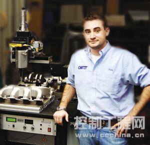

Columbia Marking Tools engineer Andy Habedank says switching among the 2D marking methods can be done quickly
Columbia Marking Tools engineer Andy Habedank says switching among the 2D marking methods can be done quickly. This flexibility is needed because engine component materials include cast iron and hardened 4140 steel with a range of surface treatments. Source for all photos: Cognex
        Wegner Motorsports, which provides spec kits and assembled engines控制工程网版权所有, overcame this application challenge with the Columbia Marking Tools 3 in 1 Marking Systemwww.cechina.cn, which produces two-dimensional (2D) barcodes using dot peen, scribe and laser marking methods so it can mark virtually any surface. A key to the success of the marking system is its integration of a Cognex In-Sight 5100 vision camera. The camera instantly grades the mark to verify that it can be read during the track-side inspection process—which happens to use Cognex DataMan ID readers.
