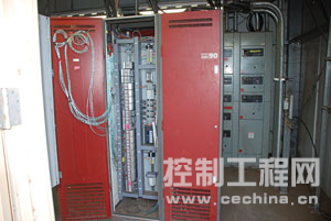

To stay on budget, some equipment was reused. New Ethernet equipment was installed in the old control system cabinets
        To stay on budget, some equipment was reused. New Ethernet equipment was installed in the old control system cabinets.
        approximately one year with the generator again 'on-line' and with significant improvements adapting Ethernet-based I/O Net Concentrator Systems (NCSs) from Moore Industries.
