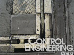

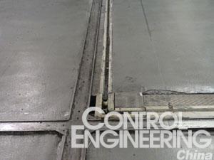

  The sharp angle of the bolster cable (shown in close-up left) inevitably caused wear that resulted in outages. Radio communication proved a solutionCONTROL ENGINEERING China版权所有, despite the extensive solutionCONTROL ENGINEERING China版权所有, despite the extensive presence of 10-inch-thick steel plate. Source: ProSoft
