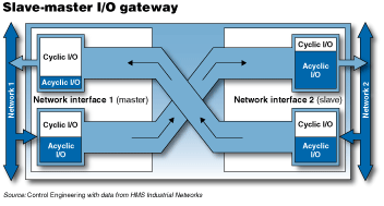

  A slave-master I/O gateway is a master to the end devices on network 1 and an I/O slave device on network 2. It transfers outputs from the controller on network 2 as outputs to the devices on network 1. It will also scan the devices on network 1 for inputs and transfer these as inputs to the controller on network 2.
