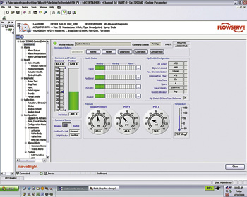

  Dashboards show the condition and functionality of every valve in the program
        Dashboards show the condition and functionality of every valve in the program.
        A typical GUI for a single valve.
