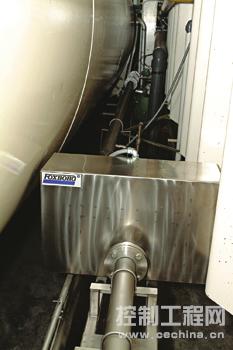

In some situations, the physical configuration of a flowmeter can be
a major consideration. Make sure a device can survive in its
        While selections of a physically incompatible technology (For exampleCONTROL ENGINEERING China版权所有,, using a magnetic flowmeter for a non-conductive liquid) are generally very rare控制工程网版权所有, less than optimal choices are more common, and oversized devices turn up in to some extent in virtually any plant environment. Ultimately, selection problems emerge more from misunderstandings related to the process than misunderstandings of flowmeter technologies.
